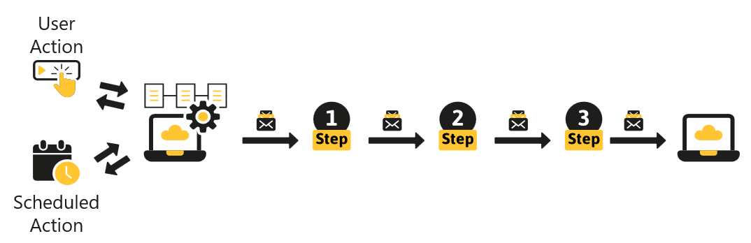

    Executing operations on virtual offices like starting, shutting down or updating TallyPrime to a different version requires orchestration of numerous operations that govern the state of various AWS infrastructure resources allocated for each virtual office.
    Being a distributed system, TallyPrime on AWS employes asynchronous messaging to ensure the operations performed on virtual offices are executed reliably even at massive scales.
    Any operation on a virtual office or a virtual computer, whether it is triggered by a user or by the system, goes through an Operation Pipeline consisting of multiple SQS Message Queues and AWS Lambda Functions.
    Communicating at scale
    Each lambda function represents an independent, idempotent, retriable, and atomic piece of logic which is a part of serving the user request. To serve the whole user request, lambdas in the pipeline work together by communicating with each other using asynchronous messaging queues as opposed to API calls.
    Each lambda has its dedicated inbox of messages (SQS Queue) where messages await their turn. After a message is picked up and successfully processed by a lambda, it moves to the inbox queue of the next step in the pipeline. But in case of any unsuccessful processing of the message due to reasons such as throttling applied by the cloud provider, the message moves back to the same queue for it to be re-retried with an exponential backoff ensuring robustness.
